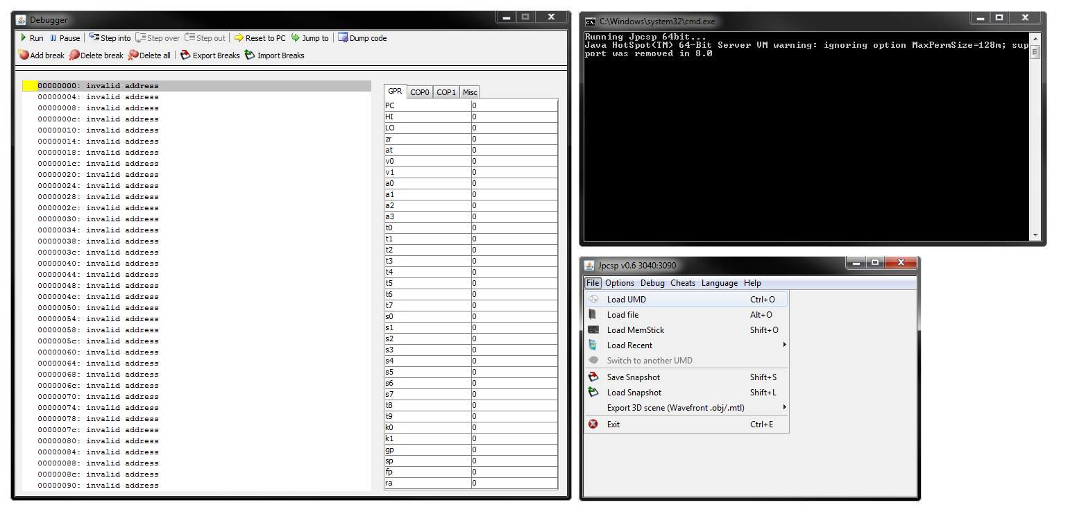

Setting up our Emulator
I'm going to use JPCSP here as its the 'better' one for our purpose in my opinion. (There however are differences to PPSSPP in performance and rendering some stuff for special cases though)

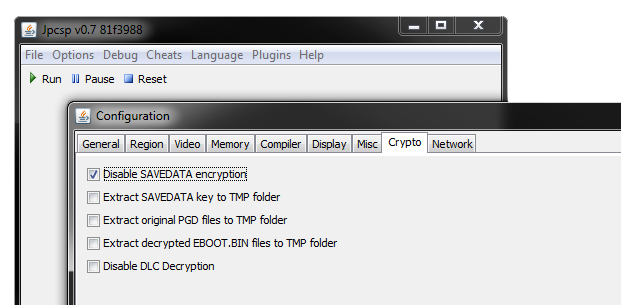

Enabling the debugger: (to make the debugger start by default you need to add a '-d' to the start parameters in the start.bat file)
Turning save-encryption off

Lets launch our JPCSP and select the game.

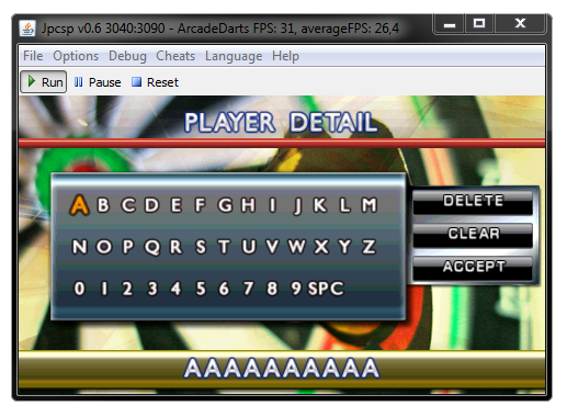

Depending on the game you have to actually play it, select a username and that kind of stuff until it saves for the first time. Once the save dialog is over you can now close the emulator.

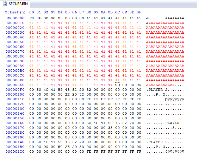

Editing our savegame

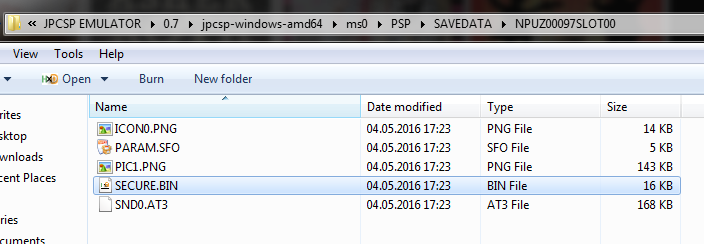

You can now open the saves location (JPCSP/ms0/PSP/SAVEDATA/) and it should have created the savegame containing all the normal savegame files (ICON0.png, PARAM.SFO aso) and our actual data in .bin format.
In case of Arcade Darts the file would be 'SECURE.BIN' and thats where all your Userdata is kept at.

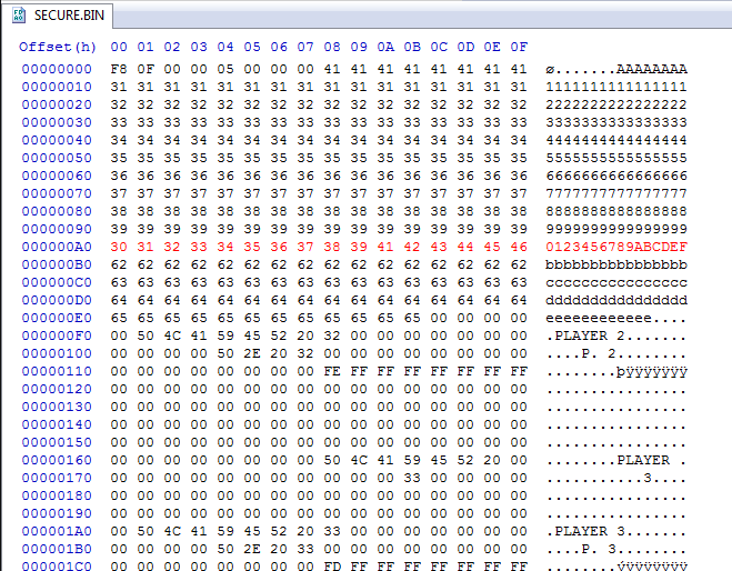

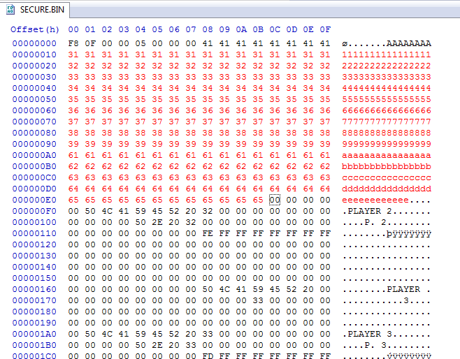

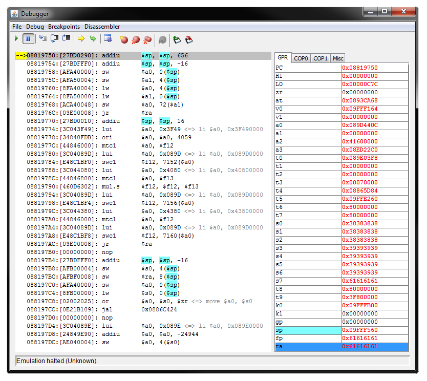

What we are going to do now is basically filling it with junk and see if that affects the game!!
Why A(s)? Because their Hex ID would be 41 (B = 42, C = 43 aso) and thats easy to recognize later on when analyzing a crash.
Loading our custom Savegame

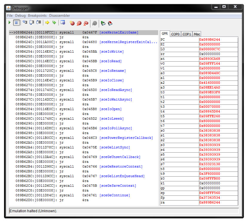

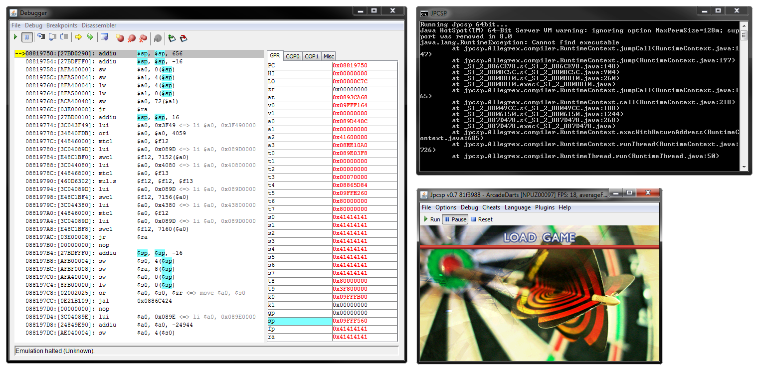

Yup, it crashed! And by looking at the debugger we can see that the return address ($ra) got overwritten by our AAAAA(s)! Note: As mentioned earlier this is the easiest and best case scenario since we can directly return to any address in RAM we want. This is an exploit!
However, more commonly you will only have some of the registers influenced. From there you will need time, pacience, understanding of how MIPS works and probably a real PSP with PSPlink to debug everything.

Normaly the registers should start with 0×08, 0×09, 0x48, 0x49 or have 0×00000000, 0xDEADBEEF. Other registers with unusual addresses (i.e. 0×61616161, 0x534F1B20 and any other weird looking addresses) are influenced!

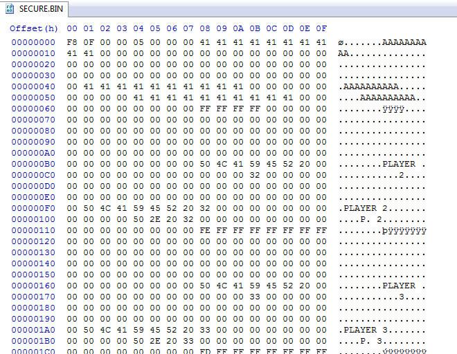

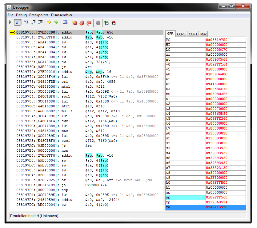

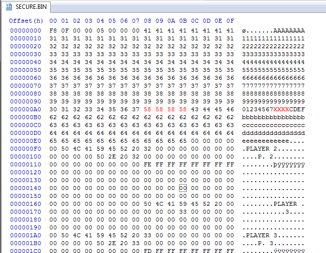

Next up we need to locate the exact offset of our $ra. To do that we simply compartmentalize our area with different values.
Now we already know which line (the one filled with aaaaaaa) and are close to the exact offset. Just one more time should do it..
There we go!

Basically what we are doing now is redirecting the function to return to the exit-function which simply exits the game. So when the game exits after loading our savegame we know it worked.

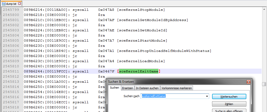

At first we need to find out the address of the function 'sceKernelExitGame' (which every game should have!) When doing this on a PSP we can use PSP link to create us a list of all imported functions. But since we want to do everything with our emulator we are going to look for it manually in the memory.

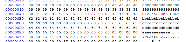

We can now write the address 0x089B6240 to the exploited function's $ra address. Because of endianness in the HexEditor that would be
40 62 9B 08
And now test it: Yes it jumps right to the exit function!

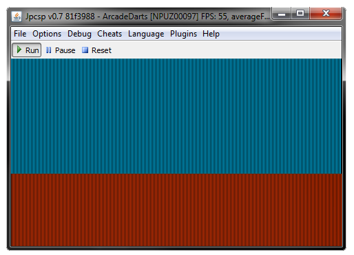

Creating a Color Flasher PoC
Download these simple ColorFlasher source files and compile them yourself.. or download this pre-compiled binary for Arcade Darts right here.

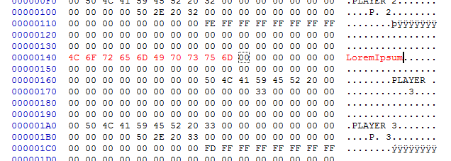

Find the address to jump to where we will store the ColorFlasher code

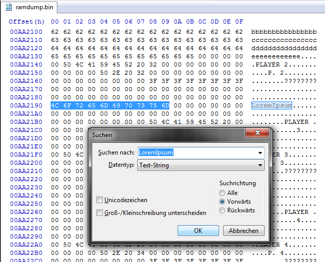

To find the real address we need to find and calculate it manually! Therefore we are going to write some unique string somewhere in the savegame with enough space.
After the savegame was loaded we can make a RAM Dump 'ramdump.bin' which will be about 32MB big and then open it again with our HexEditor
Next we simply search for the unique string and check if the savegame memory block was loaded completely or splattered all over the RAM. This one is fine..
To get the real address we need to calculate:
0x08000000 + 0x00AA2190 = 0x08AA2190
Now lets open the Memory Viewer and go to 0x08AA2190 to check if we see our string. If yes we calculated correctly!
We can now write the address 0x08AA2190 to the exploited function's $ra address. Because of endianness in the HexEditor that would be
90 21 AA 08

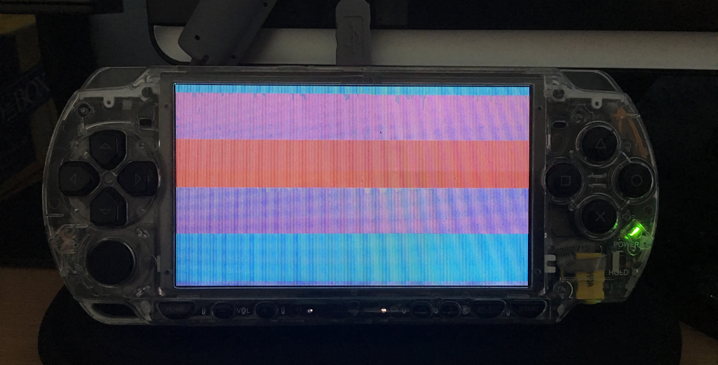

All we need to do now is place the ColorFlasher code in our save where our string started..
And now lets run the game, load our save again and see..
Done! I hope this helps understanding the process of exploiting a little better and motivates some of you to go hunt for yourselfs. Oh and of course our ColorFlasher works on a PSP as well ;)
