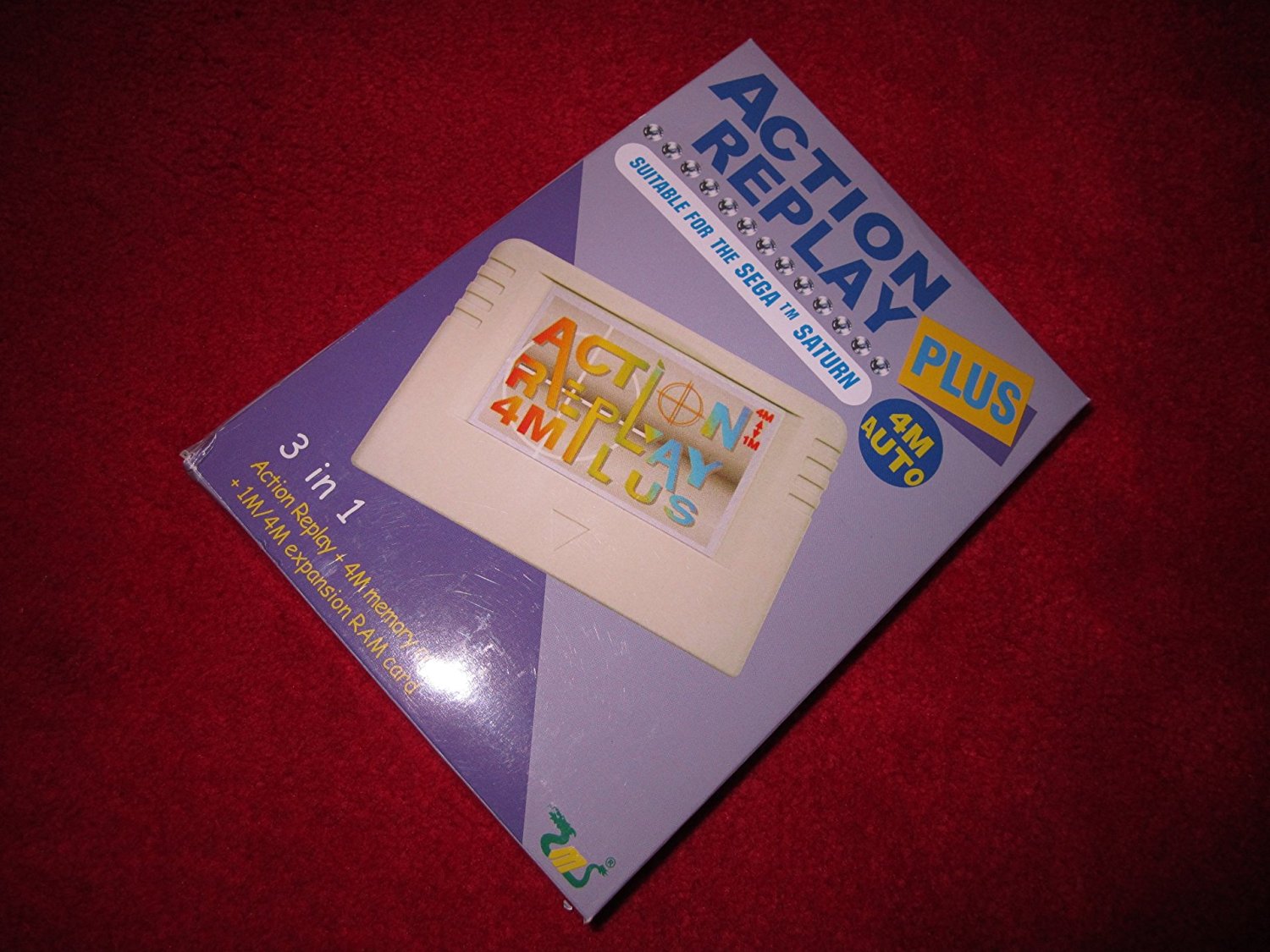

This method is called Pseudo Saturn and what it is, is basically a modded Action Replay/GameShark/Memcard cartridge that will boot back-ups and imports without using the swap trick and damaging discs.
Things you will need:
Action Replay or Gameshark 3in1/4in1 or memcard

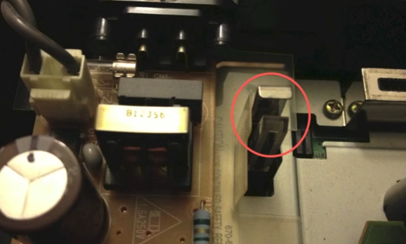

Unscrew the Sega Saturn console
Take lid off
Tape the lid switch located at the back left together so the Saturn thinks it's closed whilst the lid is off.

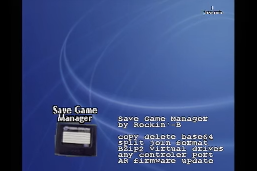

Scroll all the way down to FIRMWARE and press A
Scroll all the way down to another screen to PS031.bin and press Start
Scroll down to Flash Action Replay and press A
Press A again
When screen changes to Action Replay Flasher screen, press and hold A+B+C and then press Start
Wait until it clearly says DONE (Takes about a minute or two)
Turn off Saturn, remove tape on lid switch and screw Saturn back together

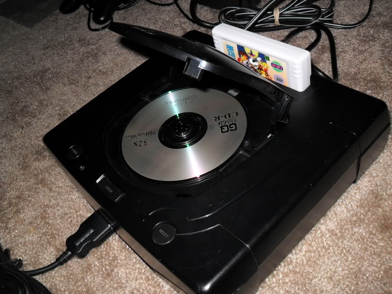

Boot Saturn with Backup in the drive and the Cart in the slot
Choose Start Game and you are done.

Start Saturn with Atlus installer in the drive (No Carts in Saturn)
When you hear the first sound of the drive laser moving "bzzzt" swap for a real game
When you hear that sound again "bzzt" swap for the Atlus installer again
It should now load the Altlus installer.
